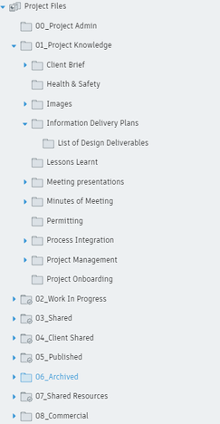

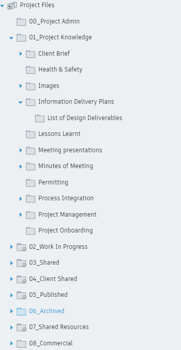

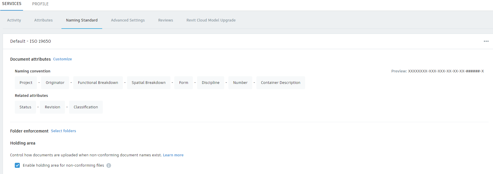

In a BIM360 project the BIM manager has set the Naming Standard as default for certain folders:
Due to this settings it is not possible to copy the ESRI_CAD.prj/.wld3 files in the folders and subfolders with the v-symbol
  • This would mean that for every .rvt, .dwg and .ifc file manually the .prj and .wld3 file must be created and uploaded.
  • GeoBIM will not be able to georeferencing .rvt, .dwg and .ifc files

Hi @Stefan_Thorn in our December 2022 release of ArcGIS GeoBIM, we have included a new way to apply a universal projection similar to the 'Esri_CAD.PRJ' option that will meet ISO 19650 naming conventions. As long as you save the universal projection as ".UPRJ" or ".UWLD3" for world files in a folder, ArcGIS GeoBIM will recognize that as a way to project and locate all models stored within that folder. So any name before the '.uprj' will work when we search to create model boundaries.
