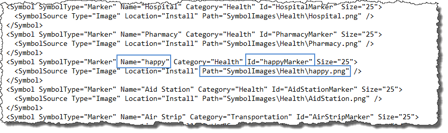

In the Explorer (x86)\Styles folder, add your icon as a .PNG image to the SymbolImages folder.  (Explorer uses 64x64 for image size, if you use larger images and lots of them, the gallery will be slower to load.)
for Example I will add this image "happy.png" for use as a symbol.
Save the image in the SymbolImages folder.  In this case will put it in the "Health" folder.
Now I am working with English language, so I will update the ExplorerSymbols.xml file to reference the image in the Symbolimages\Health folder.
<Symbol SymbolType="Marker" Name="happy" Category="Health" Id="happyMarker" Size="25">
      <SymbolSource Type="Image" Location="Install" Path="SymbolImages\Health\happy.png" />
</Symbol>
The File contains information for each symbol.  In the above example, I Named the Symbol happy and placed it in the Health category.  You must give it a unique ID as well as updating the Path to the symbol.  (Note: the path does not support using a URL)

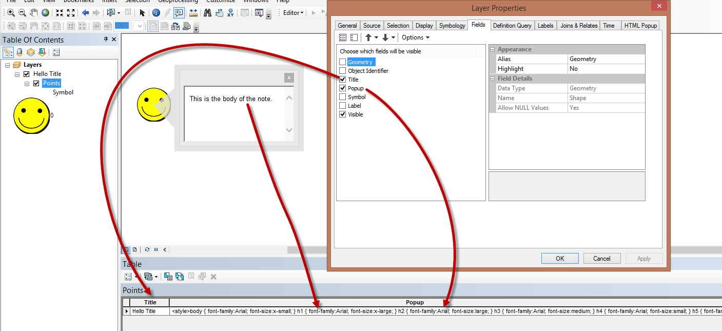

For the second part of your question.  When an Explorer user creates a layer package from a note.  The note title is put in a Title Field and the body of the note is put in a Popup field.
When you open in ArcMap it is represented as:
You users can use the Note Title to convey some information, and it is just a string in the field.  In the body case, some style is included to account for HTML that may have been in the body of the note.  In your case it is straight text.  to make it a little easier to deal with, you could add a new field and calculate it equal to the popup field, and use some vbscript or python to strip out the style information.

As far as notation of new placemarks, it's sad that the information doesn't just carry over from explorer to arcmap without any extra work. Nothing that was entered in the pop up field at all makes it to arcmap.
All I see in popup when I extract .dbf from attributes is this:
<style>body { font-family:Arial; font-size:x-small; } h1 { font-family:Arial; font-size:x-large; } h2 { font-family:Arial; font-size:large; } h3 { font-family:Arial; font-size:medium; } h4 { font-family:Arial; font-size:small; } h5 { font-family:Arial; f
and yes, it just stops at ~; f after h5 on both. huh.

The popup field in the layer package has a length of 262144  so it should be more than enough to hold the contents of the note.  The note body only supports 32,608 typed characters.
Using ArcGIS Explorer I create a note add 32,608 characters, create a layer package and the resulting file geodatabase contains a Popup field with all 32,608 characters, plus the style tags.
I am not sure why your result is truncated.
I even tried creating a KML out of the note and using KML to layer, and viewing that in ArcMap showed all of the information as well.
I notice that your string is truncated at 255 characters.  Are you exporting to a shapefile?  if you are that would be the reason.  Shapefiles have a field length limit.
