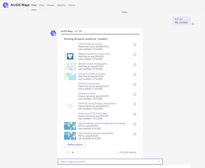

Here's a comparison between results to the My Content call in Teams:
=46 items
And then in ArcGIS Online:
=449 items
I realize that there are products that are not supported yet in Teams, but that is quite the difference. Also, I should be seeing ones that I own and serve out.

Unsupported item types could be part of the difference in numbers you are seeing, but 403 is a lot of unsupported items. I'll pass this over to the Developers to see if there's a bug, and we can discuss some enhancements to make this smoother for you.

Would you be able to conduct the same search of your ArcGIS contents in Teams but this typing in Search my instead of My Content? Does this provide you will better results in Teams?
IandeNeeve1
Thank you @SebastianSaballett
That helps. I think I am getting a better understanding as to how to use this.
