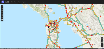

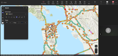

I am happy to help and investigate the issue so we can determine what will work best for you organization! For the best experience we do recommend that the latest Enterprise is used when working with your ArcGIS for Teams and portal content. That being said, when ArcGIS for Teams was first introduced we did start it off on Enterprise 11.2, and I just verified that web maps are opening in our ArcGIS for Microsoft map as well as the sketch and annotation feature in a meeting using an enterprise 11.2 portal account. Though based on your comment there are a few scenarios I can determine.
1) Which sketch feature are you working with in ArcGIS for Teams, the Sketch and Annotation in a meeting using the ArcGIS for Microsoft map or the sketch feature in ArcGIS Map Viewer?

ArcGIS for Microsoft map ex.
ArcGIS for Teams Sketch & Annotation ex.
