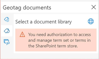

I created a new SharePoint page and added the new ArcGIS Maps web part.
After adding a layer using a SharePoint list or adding a layer from ArcGIS Online, I click the Geotag and geosearch tool to geotag documents, I receive a notification and I am unable to geotag documents.
Solution A:
Please make sure that you are added as a term store administrator in your SharePoint org.
Follow these steps:
• Login to your SharePoint Online Admin center (E.g. https://-Admin.SharePoint.com)
• Click More Features in the left hand side navigation bar. Click the Open button under the Term store to open the Term Store Management Tool.
  • On the term store management page, select Taxonomy in the tree view.
  • From the General tab, enter desired names in the Term Store Administrators box. You can add multiple users by separating them with semicolons.
  • Click the Save button to commit your changes.
Solution B:
Request your SharePoint org’s administrator to perform the following steps:
• Add new term group with the name “Esri” (case sensitive).
• Under the newly added term group (“Esri”), please create a new term set “M4SP” (case sensitive).
