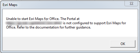

I'm trying to get Esri Maps for Office up and running with our Portal. It seemed like a pretty straight forward setup. I installed the Portal Resources, restarted the Portal and then installed Esri Maps for Office 3.1 on my client machine and restarted Excel and Powerpoint.
When I fired up Excel to start testing, I noticed that I wasn't signed in automagically - which I thought was strange because our Portal is configured for IWA. So I clicked the Sign In button on the Esri Maps tab and got this:
Not sure what to do since it doesn't really provide any guidance as to what's wrong.
