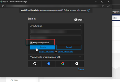

When you see the ArcGIS sign in prompt, please check the box next to "Keep me signed in". Hopefully this should help. Please do not hesitate to reach out to us if you have any further questions.

Hi @RaajRaaj Steve and I are working on this problem together. In our situation, all of our staff Portal accounts are authenticated through our Azure AD, meaning when we are presented with the sign in popup, there is no 'Stay signed in' option. I just tested your suggestion using a built-in admin account and, lo and behold, it worked. Do you know if there is a way to configure this for our authentication scheme using the AD rather than built-in accounts?
