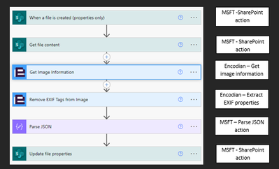

When creating the flow, I will set it up as an “Automated cloud flow” since we would like the flow to trigger automatically when new files are uploaded to the document library in SharePoint.
The first action (When a file is created (properties only)) is the flow’s trigger.

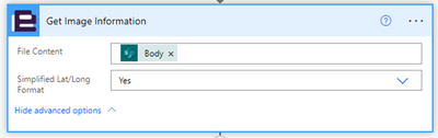

In the “Encodian Flowr” action – Get image information, choose “File content” from the previous action (Get file content) and choose “Yes” for Simplified Lat/Long Format. This action will get all the image information of the files uploaded in the document library (doc library name: “EXIF”).

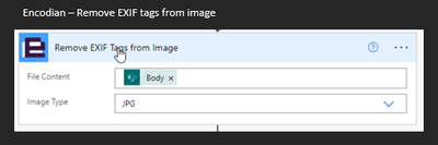

The “Encodian Flowr” action – “Remove EXIF tags from image”, extracts the EXIF properties from the uploaded image files which can be used to update the file properties in the subsequent SharePoint action “Update file properties”. Populate “File content” with the  “File content” from the previous action (Get file content). The files I will be uploading are of type “JPG” which needs to be specified in the “Image type”.

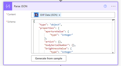

The EXIF properties in the JPG files are stored in JSON format. Therefore, I will need to use the built-in action “Parse JSON” to parse the JSON output, which can then be used to update the file properties in the SharePoint document library.
“Save” the flow and run a “Test” to see if the “Get Image file” generates the EXIF data JSON.

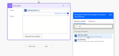

In the “Parse JSON” action, use the “EXIF Data (JSON)” from the “Get Image information” action

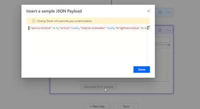

Click on “Generate from Sample” and paste the JSON output from “Get image information” action as shown in the screen capture video. Click on “Done”

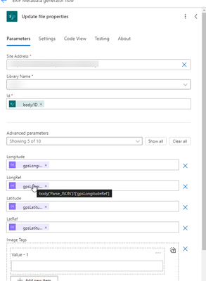

The next step is to add the “Update file properties” SharePoint action which would update the document library with the GPS data extracted from the EXIF properties of the uploaded files.
The below video illustrates the last action in the flow – Update file properties, which populates the “Longitude” and “Latitude” columns in the document library when JPG files containing EXIF GPS data are uploaded into a document library in SharePoint.

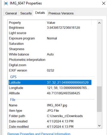

Hi, Thanks for posting the solutions. We actually tried this but we found that the Encodian Flowr converted the coordinates of Iphone photos from DD/MM/SS to decimal degree neglecting the East and West. For example, in a photo properties info (see attached file)Capture1.JPG, you can see the lat and long were recorded using the semicolon to distinguish the East and West. When Encodian converted these values, they look like this in SharePoint Capture2.JPG
So the long is supposed to have a negative value as the location when the photo was taken in in CA, USA. I was wondering if there is an easier way in SharePoint to make the conversion right. Thanks!

Thanks for reaching out to us on EC. If you view the schema in the "Parse JSON" action, you will notice the LongRef and LatRef fields as shown in the image below,
 You can map those attributes to columns in your SharePoint list in the "Update file properties" action as shown below,
and once the flow completes, you will see the LongRef and LatRef values in your SharePoint list.
I used the "Concat" function in SharePoint to concatenate the Long value with LongRef and Lat value with LatRef respectively.
