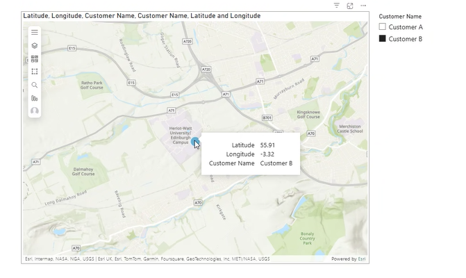

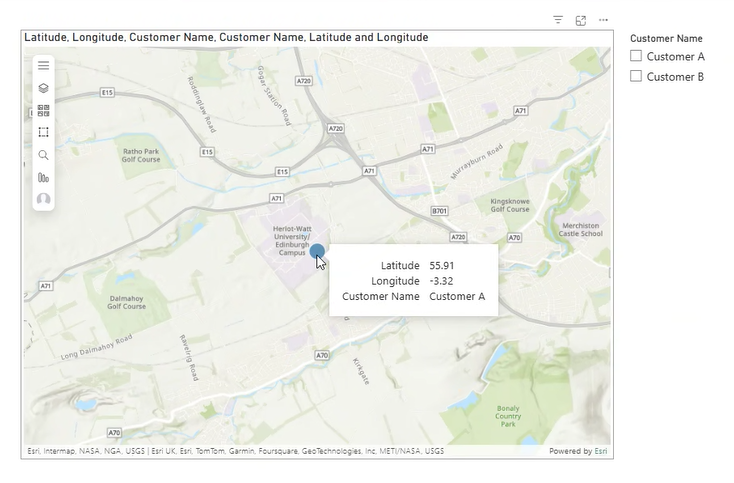

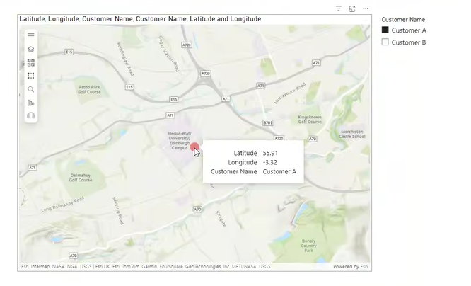

Below is a sample dataset used to illustrate the issue.
Both Customer A (red) and Customer B (blue) are at the same location, and when no filters are applied the symbol for Customer A is showing (a red circle), but the tooltip information displays the name of Customer B. There is nothing visible on the symbology or the tooltip to denote that more than one record exists at this location.
When slicers or filters are applied, the individual customers (and their associated symbols) are visualised as expected.

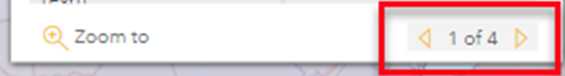

We are looking for a solution that allows users to identify that more than one record exists at the same location, and ideally the ability for the user to toggle from one record to the next without needing to apply a filter (as per previous releases of ArcGIS Maps for Power BI).
Below is a screenshot of how this used to appear

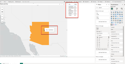

I am having a similar issue with Country fields. My map is still showing the first record for each Country. Is the behavior similar for customers using lat/long fields and location fields?

Thanks for your question! If there are more than one Power BI record for one feature(per country in your case), then it shows only one record. Have you tries the solution here? https://community.esri.com/t5/arcgis-for-power-bi-questions/urgent-unable-to-navigate-between-the-to...
Here's an example of multiple cities in one state.
