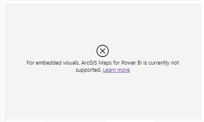

I have a ArcGIS standard account. The visual does not contain any reference layers. All that I am attempting to display is a base map and Lat/Long data from within Power BI.
The visual renders just fine in PowerBI.com and the Power BI embedded playground.
What do I need to do to get a simple map to render with my embedded Power BI report?

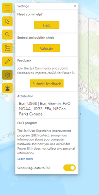

I have an identical problem.  I cannot find the publish Embed and publish check category spoken of in PowerBI.com or the desktop version.  How has this been resolved?
AnthonyLatini
Hi there @SéanAchim ! My name is Anthony and I am a product engineer on the ArcGIS for Power BI visual
To get the validation tool to appear in the Settings menu, you must be signed into an ArcGIS account to see it. If you are not signed in, it will not appear in the Settings menu.
Reference: Embed a map-enabled report—ArcGIS for Power BI | Documentation
Please let me know if this helps!

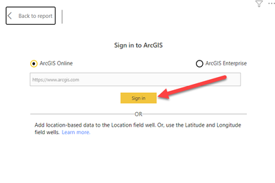

For this process, you should be able to use the following steps to sign back into ArcGIS for Power BI.

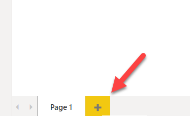

1. Create a new tab at the bottom of the page
2. Add the ArcGIS for Power BI component to the report page
3. Once you sign in on the new page, you can tab back to the report page that contains the original map and it should be signed in.
