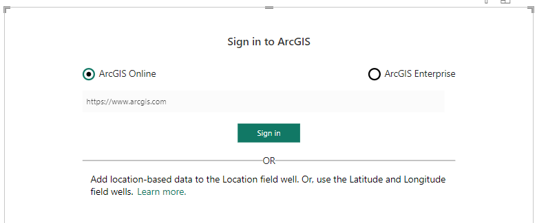

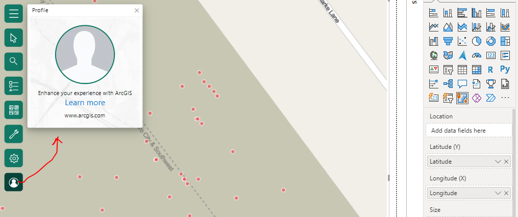

Is there a way to set or change the arcgis server information on the powerbi visual map after fields have been mapped to latitude and longitude (thus displayed on the map)?
It seems I can only do so when the visual has not been initialized or linked with any data, and if I remove the fields mapping to reveal the portal config page, then I lose all the symbology configuration.
There is a login like button in the toolbar, but it seem to be only suggesting to connect to ArcGIS, with no button or fields to actually do so.
This is for instance a big annoyance if one does testing on a uat server, and then need to delete all the mappings to change the server to the prod environement, only to have to reconfigure it all. Hoping I am missing a simple trick
With fields mapped
without any fields mapped (only way to change server or log in)
