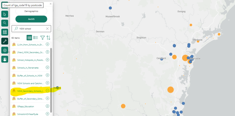

Hi Community,
Why can't I add multiple reference layers to the ArcGIS visual in Power BI. For instance, I want to show hospitals, schools and bus station in my map. But if I select more than one reference layer, the prior chosen on disappears. Is it a limitation?
ArcGIS Maps for Microsoft Power BI – March 2020.1 Release (esri.com)  This say it can be done but this is the old version of the visual.
AnthonyLatini
Hi @Sansoden - to add multiple reference layers to the map, you must be signed in with an ArcGIS Online or ArcGIS Enterprise account. Standard users can only add one reference layer at a time. This is why when you add one, it will remove the previous layer and add the latest one you clicked on.
Please let me know if this helps!
Reference: Reference layers—ArcGIS for Microsoft 365 | Documentation
