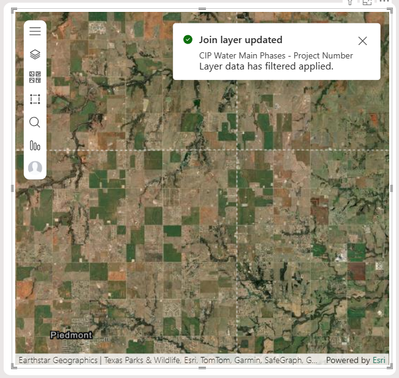

Additionally, every time the map visual page is navigated to, the Join layer updated/Layer data has filter applied popup covers a large portion of the map. Is there a way to turn this notification off?

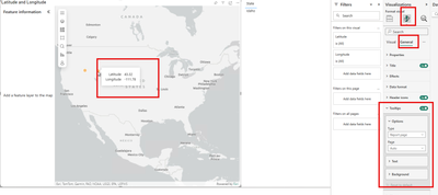

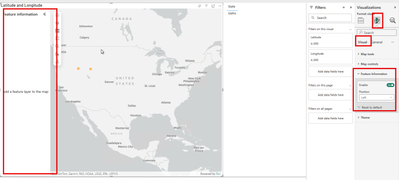

For this question, if you are asking about ArcGIS feature layer/Join layer, toggle off the feature information option from the format visual pane. If you are asking about Power BI data layer, toggle off the Tooltip option.

No, every time the page is navigated to the map has the pop up shown in the screenshot. With smaller maps the pop up covers almost the entire map. And with several filters there are multiple pop ups that need to be closed to even see the map.
