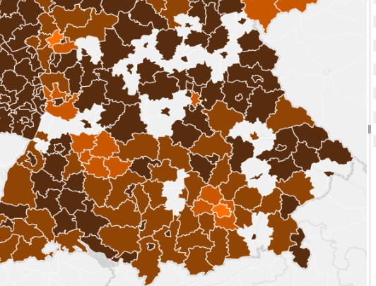

Hallo,

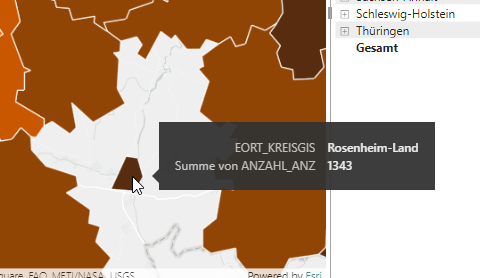

ich habe ein Problem mit der Anzeige von Landkreisen zu Städten mit Bezeichnung Land/Stadt.
z.B. Rosenheim-Land und Rosenheim-Stadt.
In den Daten bei mir stehen Summen zu beiden, jedoch wird nur eins von beiden in der Esri ArcGIS Karte angezeigt.
Bitte um Hilfe. Danke.
VG Christian
Hello,
I have a problem with the display of districts for cities with the designation Land/Stadt. e.g. Rosenheim-Land and Rosenheim-Stadt. In my data there are totals for both, but only one of the two is displayed in the Esri ArcGIS map. Please help.
Thanks. Kind regards, Christian

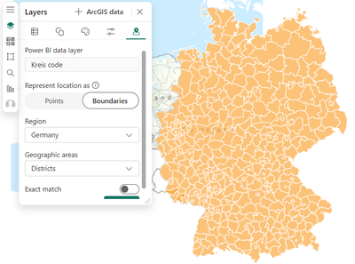

Hello Christian,
I have tried to test this with data I could find on the internet, I noticed the same behaviour with certain Landkreisen not drawing correctly. I have tested this with data from opendatasoft. https://public.opendatasoft.com/explore/dataset/georef-germany-kreis/table/?disjunctive.lan_code&dis.... Using this data I was able to draw all the features using the Kreis code in the location field well. Perhaps your data will have the Kreis codes as well, otherwise you could join this data to your existing data.
Hopefully this works for you too. If you have any questions please let me know!
