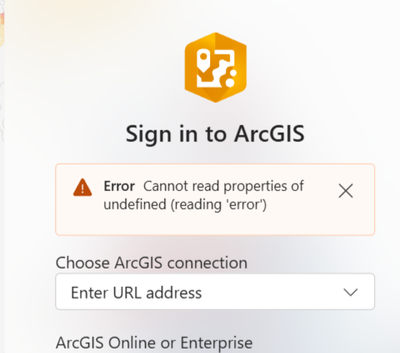

Added a ArcGIS map to Power BI and received this error.  Please Help

Hi @ChuckFessler,
Could you please try to clear the cache to see if it works?
  1. On your local system, navigate to the following locations:
    • .exe version—%LocalAppData%\Microsoft\Power BI Desktop (for example, <user>\AppData\Local\Microsoft\Power BI Desktop)
    • Microsoft Store version—C:\Users\<user>\Microsoft\Power BI Desktop Store App
  2. Delete the CEF folder.
  3. Delete the WebView2 folder.
  4. Delete the Cache folder.
  5. Restart your machine.

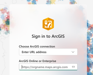

NaZhang_Esri
Hi @ChuckFessler,
Thanks for your question! Could you please add more details about how you saw that? Based on your screenshot,  I choose the Enter URL address and all looks good on my side.
Thanks!

ChuckFessler
Thank You very much, These steps worked and I'm back up and running.
