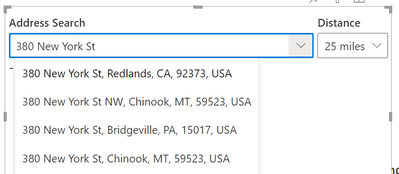

I've started building this one using a Power BI custom visual. It's a simple React UI with drop downs powered by the ArcGIS geocoding REST APIs. I used the suggest API to get address completion as you type and the findAddressCandidate API to resolve that to coordinates. The visual would then read a table from the data view, apply a haversine function and set a selection to a list of matching values.
Challenge is there's no data point representing the search location, so no way to "pin" this on the map
