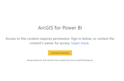

I have a few Power BI reports with Esri maps and users(including myself) can access them with no problems in the Power BI Service or PBI Desktop.
however when we try to access it as part of MS Teams App - it asks to login. We use SSO and we login but the Esri Map visual still stays like that. Anyone run into this issue? Anything we can do?

@ArcQuestions - Apologies for the delay in responding to this issue.
At the moment, ArcGIS for Power BI will only work in a Teams environment if the map does not contain any secure content (essentially anything that requires a sign in).
The ecosystem (Teams) does not allow for our component to be signed into. However, if all of the data on your map is public and not secure, then it should load properly.
As a note, I am going to move this post to the Ideas board as this is an excellent candidate for an enhancement in our component.
