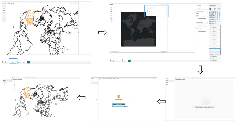

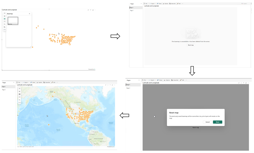

  1. If the basemap used in the visual is deleted from ArcGIS Online or ArcGIS Enterprise server
For ArcGIS Online and ArcGIS Enterprise users, if you create a map using a basemap that has since been deleted from your ArcGIS server, a blocking page will appear with the message:
The basemap is unavailable or has been deleted from the server.
This page includes a Reset Map button. When you click this button, the basemap is automatically replaced with your organization’s default basemap.
(Basemap is deleted from ArcGIS)

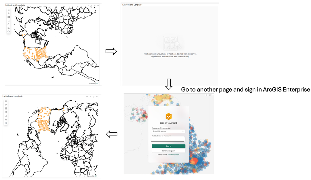

If you view an ArcGIS Enterprise map that includes a private basemap which has been deleted—and you are not signed in with the correct ArcGIS Enterprise credentials—you will see a blocking page with the message:
The basemap is unavailable or has been deleted from the server. Sign in from another visual then reset the map.
After signing in with valid ArcGIS Enterprise credentials in a new ArcGIS for Power BI visual, you should be able to return and reset the original map, which will then load with your organization's default basemap.

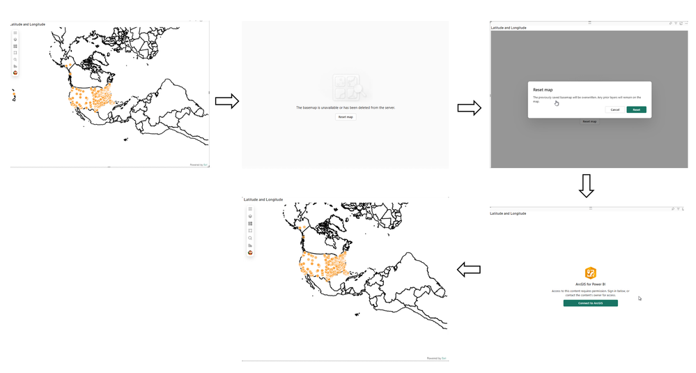

2. If the permissions to access the private basemap are changed in ArcGIS Online or ArcGIS Enterprise
ArcGIS Online users:
If you're using a private basemap and then sign out of ArcGIS Online in Power BI (or publish the report from Power BI desktop to Power BI service without the ArcGIS credentials stored in the Power BI service), a blocking page will appear with the message:
“The basemap is unavailable or has been deleted from the server,” along with a Reset Map button.
After clicking the Reset Map button, you'll be prompted to sign in. Once signed in to ArcGIS Online, the map will load with your private basemap.
(ArcGIS Online users)

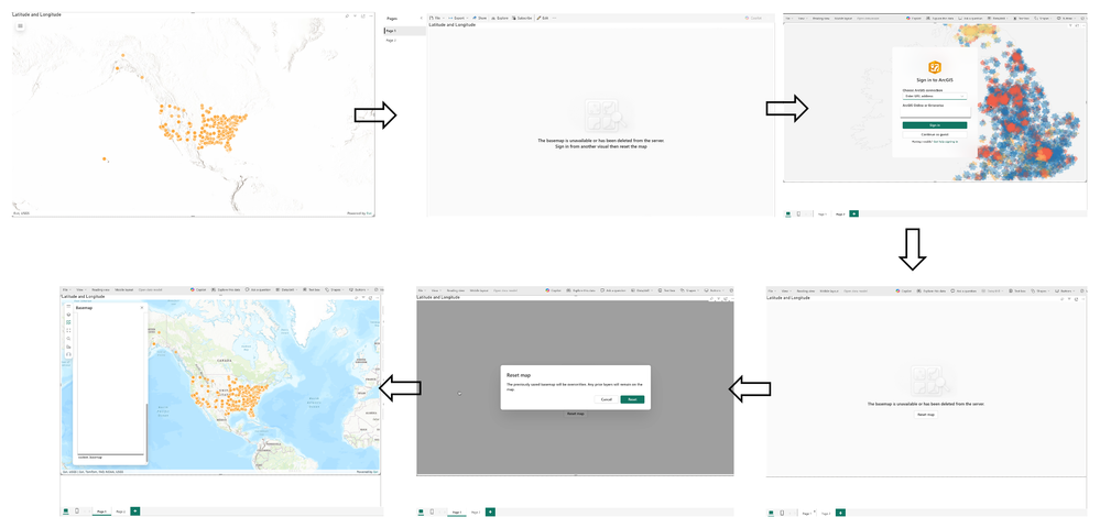

As an ArcGIS Enterprise user, you may encounter a different experience. For example, while designing a report or working in edit mode, if you sign in from another page and then return to the original map (if you open a published report that includes a private basemap as a report viewer after signing in from a different page), a blocking page will appear with the message:
After clicking the Reset Map button, the map will load with your organization's default basemap. You can then choose the private basemap from the basemap gallery.
(ArcGIS Enterprise users)
