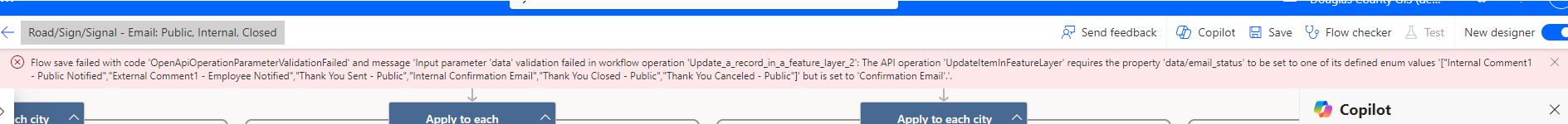

I have a number of flows set up that connect to data in AGO, listen for the feature updates, then send emails, and update email_status of the features after an email has been sent.
Yesterday (6/13) I needed to make a minor change to one of the flows (remove one value from the Condition), and when I tried to save the flow I got an error indicating that I have wrong value in the 'Update a record in a feature' action, the error basically indicated that I should use the domain description instead of domain code value.
I made the changes throughout my flow, and was able to save it sucessfully. But my flow now doesn't recognize the updates to the email_status, and it keeps getting fired when updates are made.

I have just encountered this exact same issue and it is causing me a lot of grief right now, it wouldn't let me save with the domain codes typed in, so I changed the selections to the drop down list the action provided (appreciate that new functionality) as well, but now it's not storing the domain values, it stores the description, which messes up the data and breaks symbology in the maps it's being used in.
I am not using the Update action though, I am using the Create action. And this is true for both the new and classic automate designers.

We pushed a fix for the coded values in Create a record in a feature layer and Update a record in a feature layer. Previously existing flows should be working, and the dropdown will not be available.
Available values will be shown in the parameter description, but other values will be supported.
