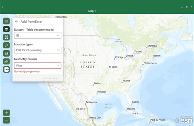

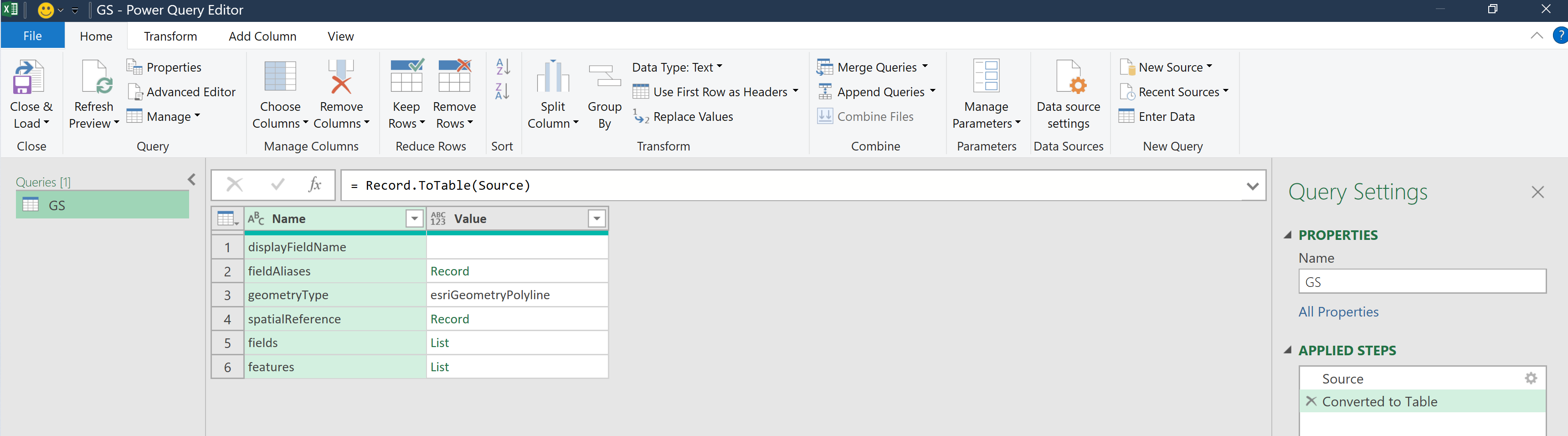

Hi, I am trying to create line features with the ArcGIS for Excel extension, from a JSON file I have exported from ArcGIS Pro. With reference to the screenshots attached, can anyone advise how I need to reformat the JSON (using power query editor or other means) in order for ArcGIS for Excel to recognise the JSON geometry?
Many Thanks,
Andrew

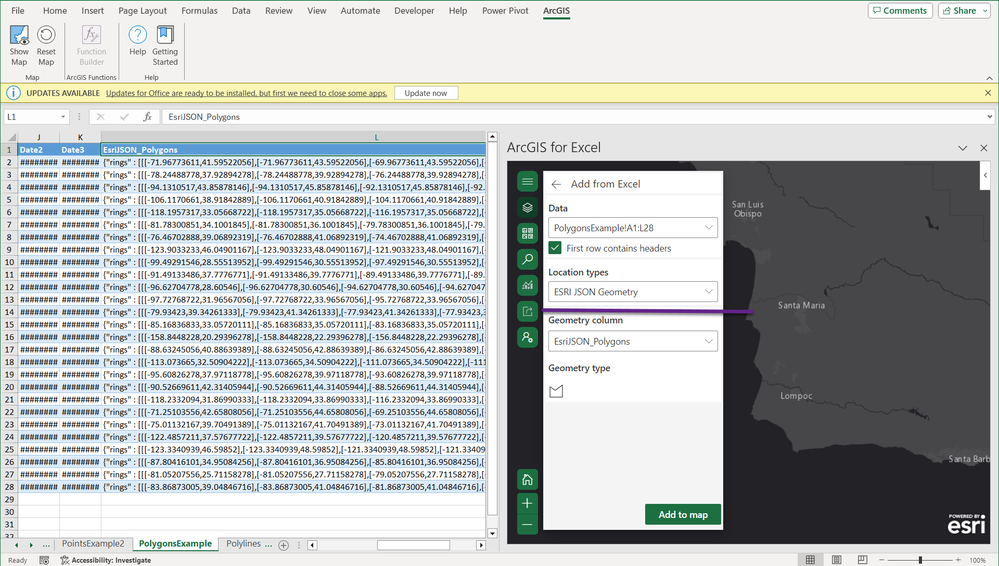

Attached EsriJSON sample datasets (points, polygons, and polylines) that works with ArcGIS for Excel. Hope it helps.
You may use the ArcGIS Pro tool 'Feature to JSON' to convert features to Esri JSON format - https://pro.arcgis.com/en/pro-app/3.1/tool-reference/conversion/features-to-json.htm

Yuchen111
Thank you SOOO much! This solves a long time puzzle for me and helps me a lot!
