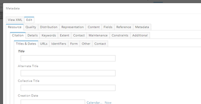

I am trying to add another tab in the Metadata Editor. Basically, I am trying to add a tab somewhere here
with two additional fields that will be saved. Can this be done?

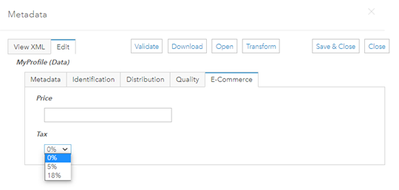

Like so?
I did this by updating the myprofile files. the attached zip has the files for it.

  • I did find the 'myprofile2' but I cannot find the esri/dijit/metadata/form/Tabs. I presume if I want to add a new tab or new field in an existing Tab, I need to do so in the /Tabs?

Like so?
by Anonymous User
Not applicable
Yes, exactly like so. Wow, thank you. I now can examine the files and use it for myself.

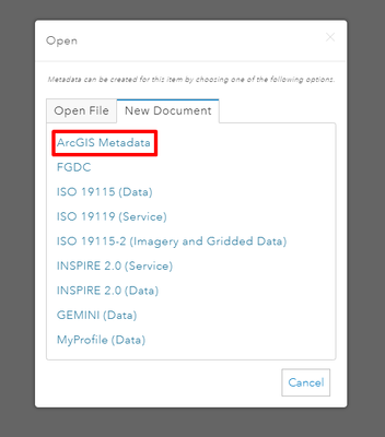

So, I login and go to the Admin menu, I choose Create Metadata and choose the New Document option.
From there, I have the following options
Is the myprofile profile supposed to be here or should I choose one of the above templates /profiles?
Marten
ah, that means you have not yet configured the geoportal to consider myprofile yet. to do so, you will need to edit geoportal\app\context\metadata-editor.js. That file lists the known and used profiles. You will see a list 'allowedTypeKeys' with quite some values. Those values are the keys of the active metadata profiles in your geoportal. You can remove some you don't need and then add "myprofile-iso-19115" to the list.
Then notice the list called 'typeDefinitions'. The entries in this list describe the different metadata profiles by telling geoportal where to find a profile (in the webapp structure) and how to recognize XML to be of the defined profile by an XPath expression ("path"), a criterion ("must":true) and sometimes a value. In that list insert the following JSON object:
  key: "myprofile-iso-19115",
  requiredPath: "app/gxe/types/myprofile/base/DataDocumentType",
  interrogationRules: [{
    path: "/gmd:MD_Metadata/gmd:metadataStandardName/gco:CharacterString",
    value: "MyProfile",
    must: true
by Anonymous User
Not applicable
Yes, that did the trick. I did not know of the metadata-editor.js - Thank you kind sir!
