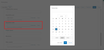

I have a date field which I'd like it to be a date field with two values - from & to. I need it to be like a range.
Have two values, a starting date and and end date.
Can this be done somehow?

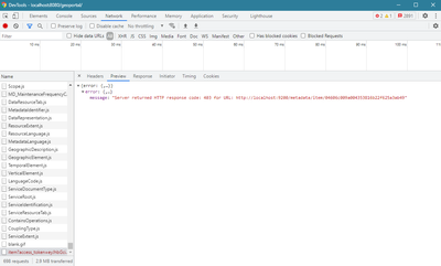

Marten,
Any other changes I need to make in order to save the metadata, regarding the temporal element? Once I click save, I get error 500 in console.
I think I also had to make changes, in other words add the new temporal element field in the Evaluator classes?
Marten
without seeing the editor, the XML, and/or the error, that is hard to say. Can you share screenshots/files of these 3 things? Does the editor allow you to view the XML? if so, can you add an example here of that?

Here is a link for the geoportal and here is the error I get
