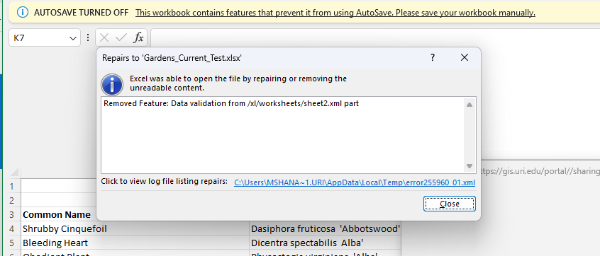

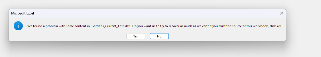

However, upon re-opening the Excel file to make additional edits, I am get these errors:
The previous edits are there, but Excel makes me save as a new file when I attempt to close. As a result, I am unable to keep updating the same Excel file when I want to make edits. I need to save as a new file at the end of every editing session, which is problematic for my end users.

If so, then we should proceed to understand if this is an Excel issue or an add-in issue. Typically Excel errors mean it's coming from Excel. I did some research on the error and found there could be several reasons why an Excel file may contain unreadable content. For example, File corruption or Excel cache is full. Could you try the workflow with say a copy of the dataset you are using? This could help eliminate file corruption and I will be checking into some of the other items you mentioned, such as character limit.

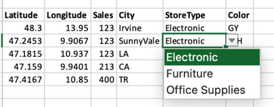

2. One possible cause, and most likely, this error has something to do with the "coded value domain" ArcGIS data type. Excel will throw this type of error if there are too many options in the dropdown.
