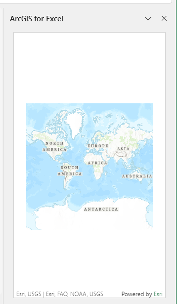

I know I had this issue last update and cannot remember how I got it to update.
I am getting a blank map with 0 buttons now.
I opened on another machine and its a different interface.
How can I get the Add-In to update?  Note this is a Managed Add-In and I cannot use the MS Store.
Thanks
DougBrowning
MVP Esteemed Contributor
No I just have the one.  I tried that a few times already.  Not going to worry about it since it is just this one machine.  My others are fine.

ShannonCardoza
@DougBrowning Hey there! The update happens upon opening ArcGIS for Excel. You can verify once you sign in > under Login > settings. You may need to clear your browser cache.
-SC
Shannon Cardoza
Product Engineer
DougBrowning
I think the issue is IT installed it manually.  Then later it was added as a managed Add-in.  But it seems its now stuck on the manual one.
ShannonCardoza
Ok @DougBrowning maybe we can try to housekeep the behind the scene details. Now you don't want to delete anything, but you can see if there are duplicate add-ins appearing (meaning you will see ArcGIS for Excel in 2 locations, one from the manual deployment and one from the admin level).
Also, are you using the Desktop or the online version?
When I open, say for example, my web browser version, I can see the following:
(view in My Videos)
Do you see ArcGIS for Excel under My Add-ins or under Admin managed? If you see it under both, you maybe able to hover over the 3 dots and select remove. This would remove the manual add-in, leaving the admin managed add-in availble. Therefore, we have 1 admin managed A4E available and updates will occure automatically.
Removing an add-in per Microsoft online resources, see link here
  • Go to File > Get Add-ins.
  • Select the "My Add-ins" tab.
  • Choose the add-in you want to remove.
  • Click the three dots menu and select "Remove".
Let's go from here and keep me posted. Now... 🤣 My disclaimer, I am not saying this will fix the problem nor do I recommend going against any company policies to delete anything. This is just an optional troubleshooting idea to try.
All the best,
SC
Shannon Cardoza
Product Engineer
DougBrowning
