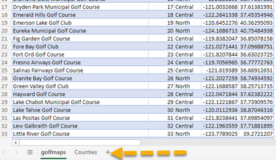

2. When you say additional tabs, are you referring to these?
3. Lastly, the 'submissions' you mentioned coming from Survey 123 are generated in an Excel sheet? If I understand that correctly can you share a sample?

Yes, additional tabs within excel.
