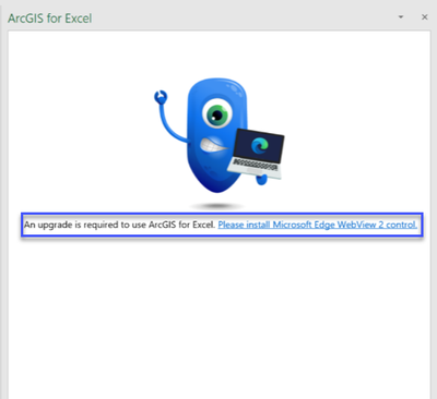

Q: An upgrade is required to use ArcGIS for Excel. Please install Microsoft Edge WebView2 control.

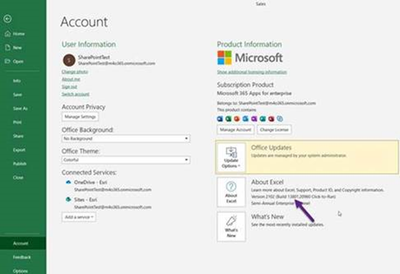

  1. Ensure that the installed Microsoft Office version on your machine is greater than version 13530. Check for Office version -> Open Excel -> Go to File tab -> Account

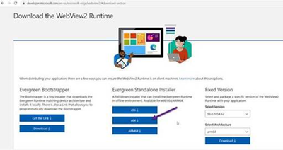

2. Install Edge Webview2 on your machine – https://developer.microsoft.com/en-us/microsoft-edge/webview2/
3. Select Standalone x64 installer, download, then run the installer.

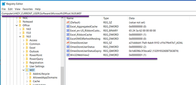

4. Create this registry key “Win32WebView2” in your machine at this location  –
HKEY_CURRENT_USER\SOFTWARE\Microsoft\Office\16.0\WEF\
5. Set its value to 1.

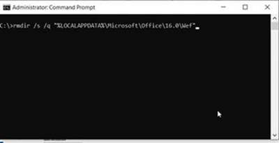

6. Clear cache. Open Command prompt as administrator, and run the following command - rmdir /s /q "%LOCALAPPDATA%\Microsoft\Office\16.0\Wef"

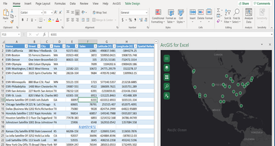

7. Open Excel -> Go To ‘ArcGIS’ Tab – Show Map.
ArcGIS for Excel map opens without any warning message.
