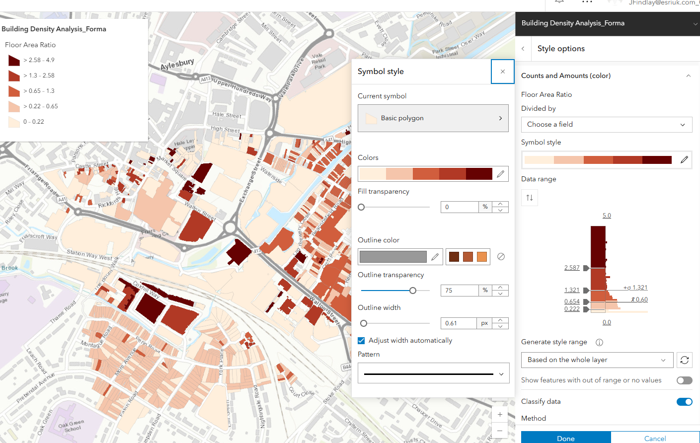

I have set up some analytical layers in ArcGIS which I would like to show inside Forma for conceptual massing. One of these layers is symbolised using graduated colours against a numerical field. Here is what it looks like inside ArcGIS:

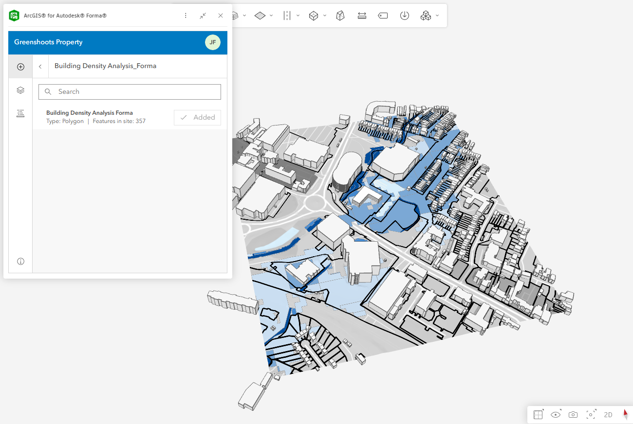

And here is what it looks like in Forma:
It just shows up as outlines (please disregard the blue layer--it is a flood layer). Let me know how I can adjust the symbology so that the layer shows correctly, or if there are any workarounds. Thank you!
Hi James! Thank you submitting your question. Unfortunately styling with Counts and Amounts is not supported. The two supported style options are Location (single symbol) and Types (unique symbols).
The only workaround I can think of would be to use Types (unique symbols) as the style option, then changing the colors like so for each type.
Hope this helps!
