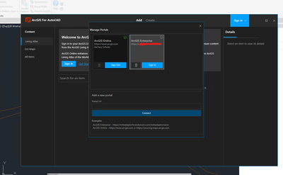

Off hand it sounds like the URL to the ArcGIS Entperise deployment might be slightly off. Would it be possible to send a screen capture of the ArcGIS for AutoCAD > Portal Manager so we can take a look?

I actually have another laptop that has AFA 420 on it and I cant connect on that one either. Its running autocad civil 3d 2022 as well.

Thanks for the screen capture Zack, but I cannot see any of the URL to even begin to check for an issue. Can you just block out your domain portion of the DLL, or send me the image privately?
I want to check you have the Portal Web Adaptor included in the URL.
