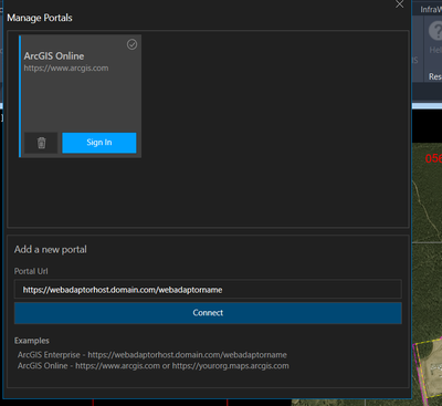

LieslHanlan
I have installed the latest version, and using the prescribed URL. Today, I am unable to connect. Last week, no problem. Selecting "connect" ... nothing happens.
DanWade
Hello,
Based on your provided screen capture it would appear my form example was just cut and pasted into the URL text box. That example URL is not going to work for you. The URL just provides the format needed for your particular ArcGIS Enterprise URL. You might need to talk with your IT and or GIS Manager to find out the correct URL to enter in ArcGIS for AutoCAD.

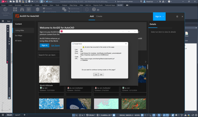

UbaidGul_opaz
I am facing this issue when I try to sign in to ArcGIS online account. When I press sign in button shown in attached file it shows this error dialog of timeout after few seconds of wait.
waiting for the solution.

I am using AutoCAD Product Version 28.0.42.6 AutoCAD Map 3D 2025 and ArcGIS for AutoCAD is most latest version. I have added picture of issue I am facing.
DanWade
A new version will be released before the end of this month that contains work around this behavior.
Thanks for your patience!
