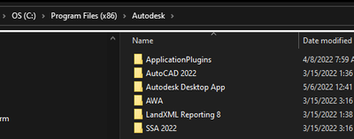

MicheleInserra
Dear @DanWade first of all thank you so much to replay me,
about the problem, unfortunally I have checked and there is the folder, as you can see in the screenshot attached,
do you have any other ideas?
DanWade
Hey,
I appreciate the screen captures. I think they are going to help us solve this behavior. I have never actually looked under (x86) folder before, but I do have the same as you at least for the folder we need, ApplicationPlugins.
We really care about the folder for 64-bit applications and your provided image on this, 123.jpg, indicate the folder we need is spelled wrong. In the image there is an extra "s" in the folder name. This is unlike the (x86) folder which is image 345.jpg.
The folder name should be: "ApplicationPlugins"
