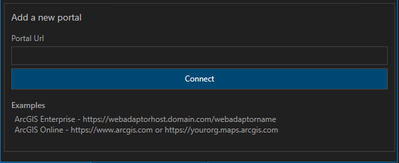

Hello Caitlin,
Thanks for assisting your Engineer with setting up ArcGIS for AutoCAD! I would really like to know the format of the URL you entered in the Manage Portals box of ArcGIS for AutoCAD (AFA). You mention nothing happens when they try to sign-in which from other posts here it sounds like the URL includes the port number. AFA provides examples of the required format of the URL. You can use a private message if you prefer.
I wonder if instead the current format is something more like https://machinename.domain.com:7443/arcgis.
As for requirements of ArcGIS Enterprise for AFA, there are non other than the deployment is functioning correctly.
