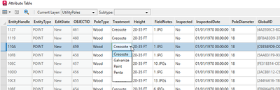

Thanks for your continued use of ArcGIS for AutoCAD. I believe you are speaking about coded value and range domains. When created, there is a predefined list of values a user can select for the attribute field value. Please check out the following documentation:
Feature layer subtypes
Web feature layers
It sounds like the field you are working with just does not have a domain assigned to it so the user must manually enter the value for the preconfigured data type.
I believe the following screen capture will display what we are speaking about:
JamesMaeding
Hi Dan, thanks for replying. Yes, its the value choices dropdowns that are not working in certain acad/civil3d sessions. It happens in the summary table and attribute editor. I replied to myself with more info before I saw your post. This is a WPF library conflict going on, I believe. We tested on the same drawing in all acad sessions, so its not a drawing problem. The solution is likely very simple, such as a support path my civil3d 2019 session had that my other sessions do not. I have experience in this so know how to troubleshoot that. Its just super unexpected as it should fail in all sessions since the program is looking to same WPF library for all. Maybe others have seen this.
Note that I am testing on drawings fully populated with gis data. The domain assignment is not the issue.
The items tested on are assigned through layers and that is all working.
thx
