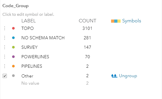

I am getting an error when trying to load a web feature layer that has a attributed symbology breakdown in my ESRI Portal. When I try and add my URL it gives me an error. If I remove the symbology based on the attribute it comes into AutoCAD just fine.

I was doing my own testing and I have seemed to have fixed the problem. I found out that there cannot be any blank values in the attribute that you are using for symbology.
In my case I had some blank attribute values in the field I was using.
