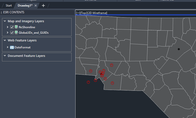

If you need to print one or more of your map/image layers, you can use the extract command from the context menu by right-clicking on the map layer in the Esri Contents dialog and selecting "extract".

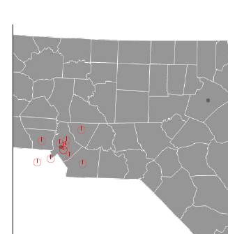

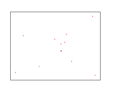

I have the following drawing with one Web Feature Layer (WFL) and two Map/Image Layers. The map/image Layers are not going to display in the Layout view at all and to work around this the function "Extract" can be used. The PDF only contains the WFL.
The output PDF:
But if I use the extract function on the Map/Image Layers first then switch to Layout view to plot or export to PDF we obtain all the layers we expect.
I hope this helps.

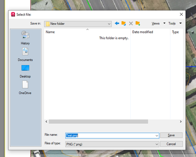

However, you have not mentioned this step:
When I right-click on the map layer and select 'extract', I am prompted to save a .png file.
Is it necessary to do this? If so, where is the best place to save this png? Will the software need to access this file at all, or can it be deleted right after saving?
whitecosmos
Here is a screenshot of the prompt after selecting 'extract':
DanWade
The right-click step not mentioned was implied by the document link I provided in my initial post.
Yes, you have to save an image file as it is part of this extract process so your map and or image layer will print/export during the output. Where you place this file and keeping the image files are completely up to you. You could delete any exported image and extract them again the next time you would like the output saved again.
