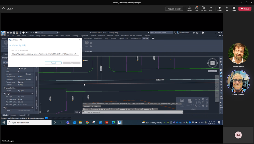

ID for a Feature Service works as you explain.  SuccessMicrosoftTeams-image (3).png

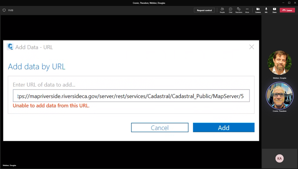

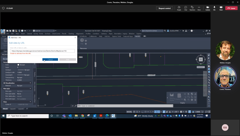

TedCronin
MicrosoftTeams-image (7).pngWe have a public server you can access if you want to test this out.

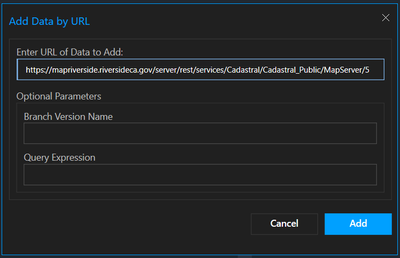

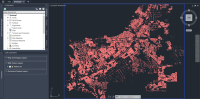

For both map image and feature services, the indices point to feature layers.
The Add data by URL dialog can be used to add web feature layers to drawings, including those containing "MapServer" in the URL.
For example, using the latest version (435) of ArcGIS for AutoCAD and the publicly available service:
https://mapriverside.riversideca.gov/server/rest/services/Cadastral/Cadastral_Public/MapServer/5
Can be used to add point features to the drawing from the 5th index, Address_Pt feature layer (all 90,000+ of them!).
