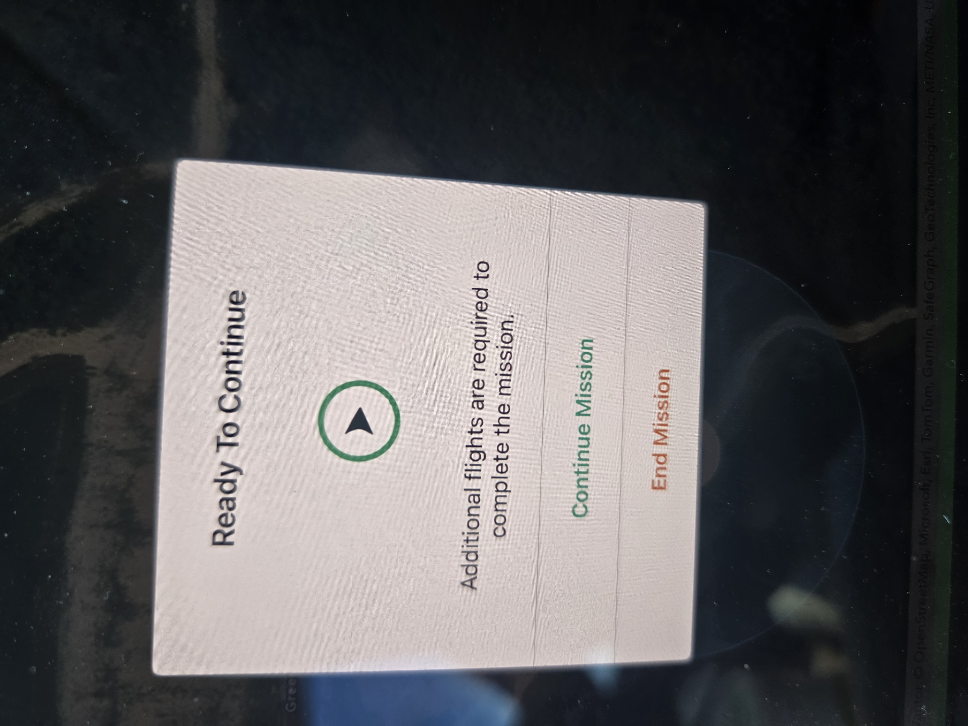

I am running into a unique behavior when flying the 360 Panorama mission to capture the tiles required to eventually stitch a 360 panorama. I fly with a 50% overlap at 121 ft for the capture. This products 29 images which is what my contract specs call for. After the drone captures the images, it says mission complete and returns to home.
However, after landing, the application shows the standard mission processing dialog but always prompts me to continue the mission as more images are needed. (I have confirmed via the sd card all images are captured)
If I click continue mission, the drone will take back off, return to the coordinates i specified for the capture and then capture the same images again. It will then say mission complete, return to home, do the processing window for a minute or 2, and then once again request to capture additional images creating a non ending loop of duplicate captures.
My workaround has been to just select end mission, shut down drone, then pull my sd card from the drone amd upload to my client. Can you advise why this loop is happening?
JakimFignole
Able to confirm this issue is no longer present if 1) the sd card is formatted per the documentation steps, 2) all other flight apps on the smart controller are force stopped BEFORE launching the connector. It will then fly the mission and recognize the images captured. Marking as closed
