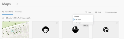

In ArcGIS Online now and when Enterprise 10.9.1 is released you can view all maps you can edit by using the filter and changing it to "All maps".
GWaltersOZ
Hi @Anonymous User thanks for the speedy response and glad it was a user error.
Having said that, I would like to suggest that you should just have All Maps as another tab between My Maps and Hidden. This would keep consistency with other pieces of ArcGIS Online UI.
Thanks again,
Gareth
