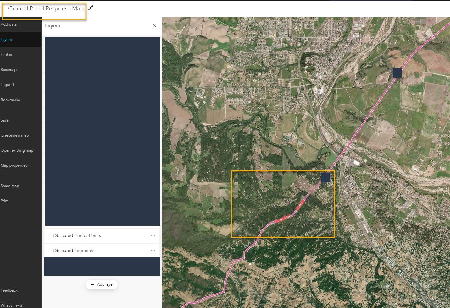

We've set up a map with an arcade expression that divides the features into different time period groups for map symbology. All of the features are visible in the web map but when we look at the same map on Field Maps app only some of the features are visible. How can we fix this? Is this expected?
In the photos we're looking at the red polygons, not the green centerpoints.
Here's the view from the web viewer:

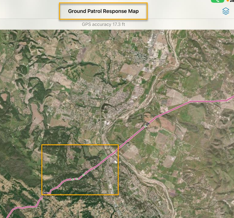

And here's the same map in field maps.

Unfortunately there is a bug in the ArcGIS Runtime 100.10 version that Field Maps uses for it's current and next release (hopefully going out next week) related to the locale of the time returned by some Arcade expressions. This bug has been addressed with update 11 of the runtime and it's likely that Field Maps will release in June or July with this update.
If you'd be willing to share your maps with us, we might be able to verify if the issue you are seeing is the same or related to this. You can add the user arcgisfieldmaps to a group and share the maps and layers with the group if you'd like us to take a look.
