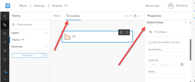

Default values can be set/changed in the Template tab of the Form editor in Field Maps Designer:
