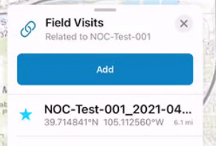

This Pop-up Title is on a related FC.  When I go to the parent and list the children it works fine with 1 record.

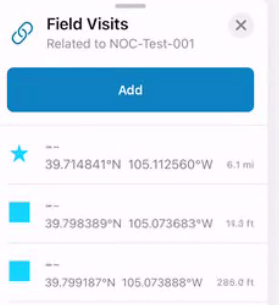

But if I have 3 children the list will not show the Pop-up Title.  (note sometimes it displays online but when I go offline it stops working)

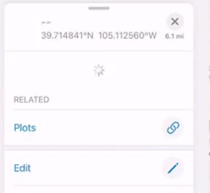

And then the entire popup also breaks.  Just spins.

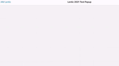

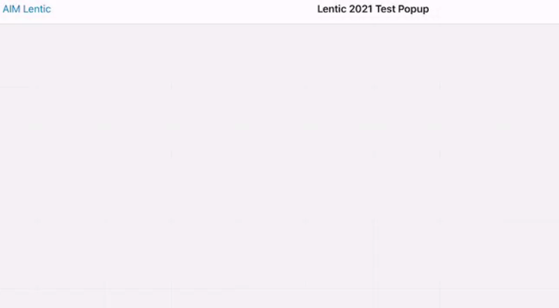

The map just spins
Then basemap goes away.

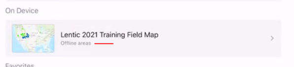

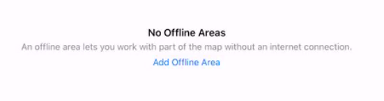

It says it has offline areas but none found.

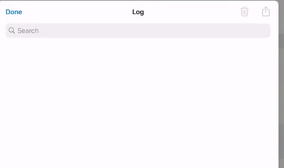

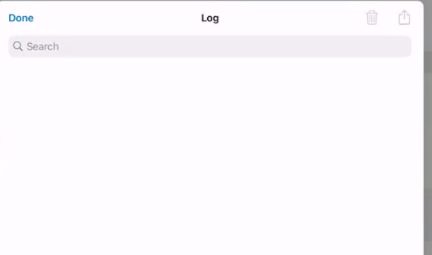

And even the log files breaks.  Just blank screen.
