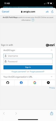

Dear community,
does anyone has a screenshot how the Login-Dialog in ArcGIS Field Maps looks like, when using useInAppAuth=true (described here: Mobile device management).
We applied useInAppAuth=true but when starting the ArcGIS Field Maps Login Dialog looks like the same as without this setting.
So I think this settings was not applied correctly to the app ...
Maybe there is another way to check if this settings was correctly applied to the app?
(we are using Blackberry UEM and iPhone as device)
Regards,
Daniel.

ColinLawrence
Hi Daniel,
I have not worked with Blackberry UEM before but it should look like this for in-app auth:
The standard oauth screen for comparison:
Can you confirm you are seeing the standard page still even with this MDM setting set and deployed?

dstrigl
Hi Colin,
thanks for your fast response! Now it works and (as shown in your post) the "in-app" login dialog appears.
The problem was a wrong app-config in the Blackberry UEM by our colleagues.
Thanks and regards,
