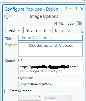

PopupConfig.pngPopupConfig.pngPopupConfig1.pngPopupConfig1.pngI have arcade expression that work fine in a browser, but now in Field maps it is opening the the image rather then the link! They worked fine previously at some version and I just noticed they weren't working, so downloaded the latest version of Field Maps, but instead of going to the link it opens the link image. This is really quite just nuts.

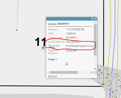

BlueSky17
What hyperlink format do you use in FieldMaps to open up the pictures (or documents) that are stored on iPad?
For example, I need to update this hyperlink so the guys out in a field can open up a pic that would be stored on the device.
Any ideas? Thanks.

DarylHochhalter
This is in Android but
One of the things that can be done is to use an expression to generate a link, then use that along with a URL to a pic in the popup media. In Field Maps when you tap the image it opens in another window, the options there allow you to open the link. In my case, it downloads the file to my phone/tablet, before opening. The same format is a nice single click to open in the browser with the same web map. Not great but gives access for now.
