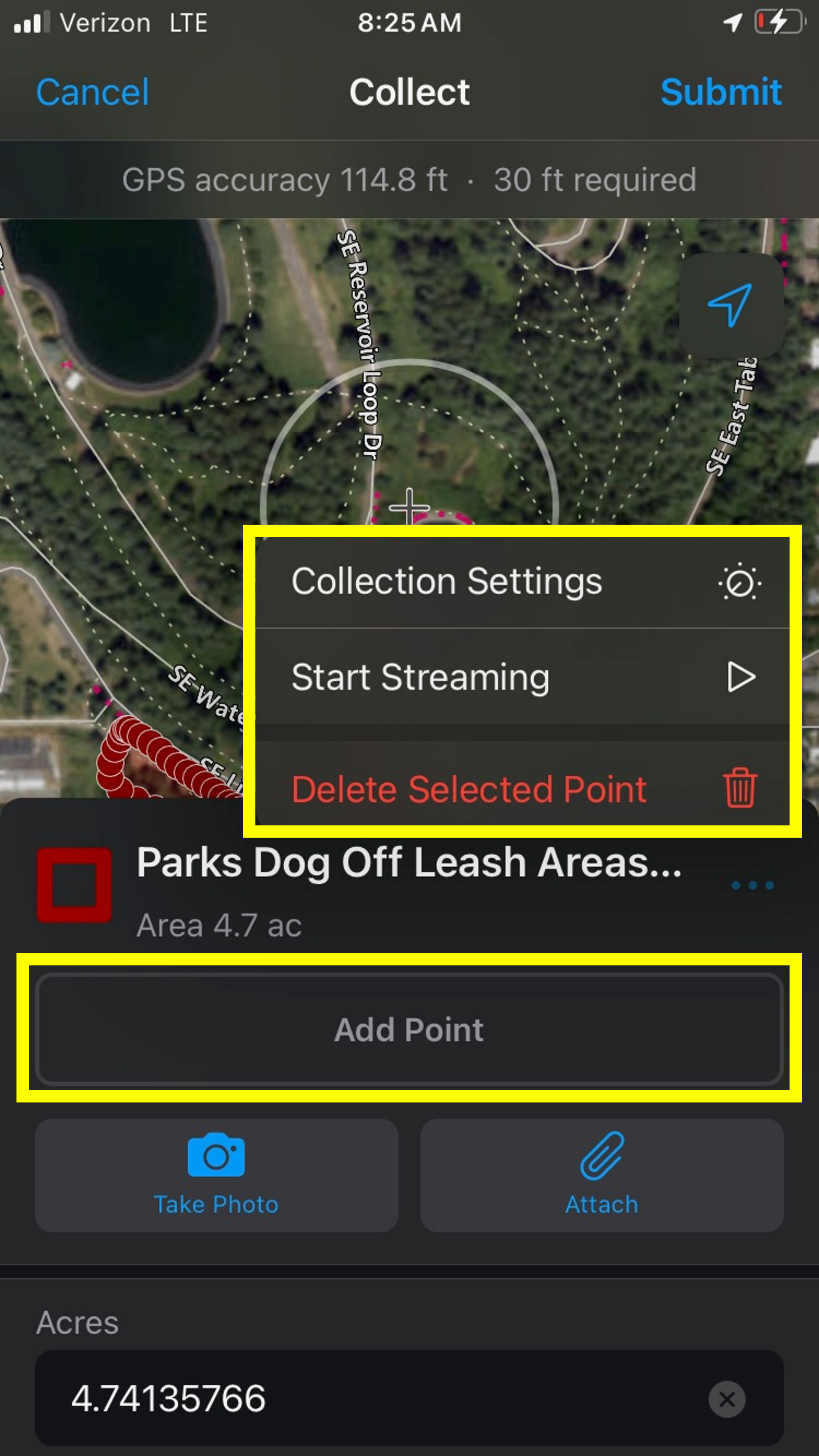

I have an issue being able to edit the geometries of a particular polygon service within field maps. The problem only occurs in the field maps environment (I'll cover this later). The problem service data source is an SDE feature class, which is now on the portal. Full editing capabilities and privileges have been given to users to update, add, delete, and select. Full editing capabilities were pushed up to service on portal as well.

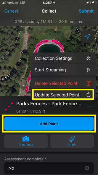

This feature is fully editable; I can edit the attributes and delete features but cannot modify the feature's vertices if desired. Also, If I try to add a new feature in field maps, I can place only one point, and then I am not allowed to place any others to create a polygon. This is a screenshot of what shows up in field maps when trying to edit the polygons vertices. Notice there is no option to "add point" or "update selected point"
When I open the web map, I can edit attributes, vertices, delete features, and add features with no issues.

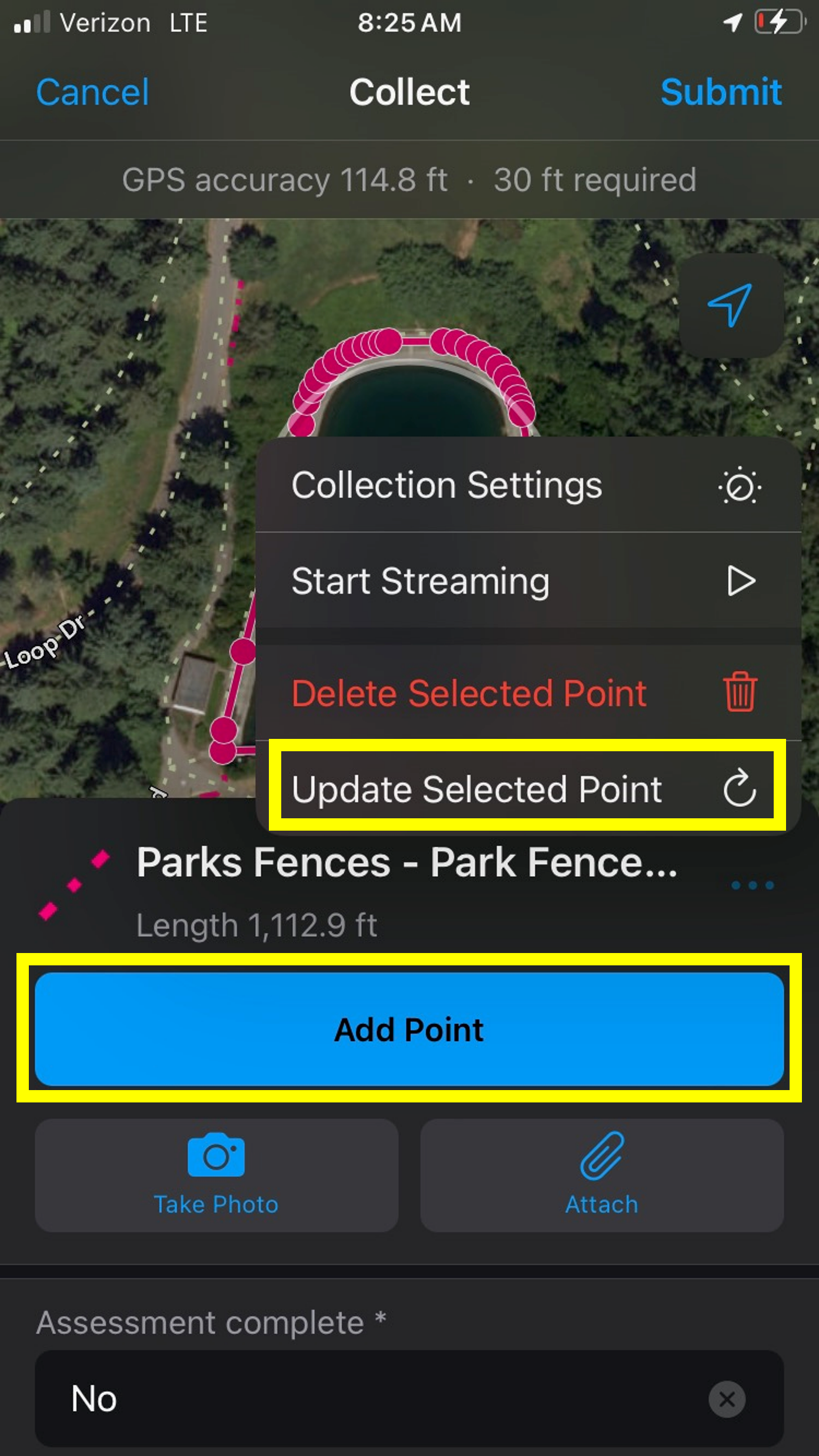

There is another line feature in the map, which performs correctly and has all the same settings in both field maps and web viewer. This is a screenshot of what is visible for editing the line feature that is performing correctly. These are the desired settings I would like to see available for the polygon, and I can't figure out why they are not present.
