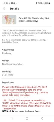

Can you send me a screenshot of the field map information page (I'd check if both of these are the same field map):
Cody
NigelCharman
Hi, here's a video of it happening - .https://drive.google.com/file/d/1N2LT2Rhf_z2QsXVaRKDJ8ajux5mIk0pC/view?usp=drivesdk. After I type "ca" or "cam", I'm not doing anything else, Field Maps automatically shows the login prompt. It's just a question of how fast I type "cams" before Field maps shows the login.
Here's the info page:
  Nigel
