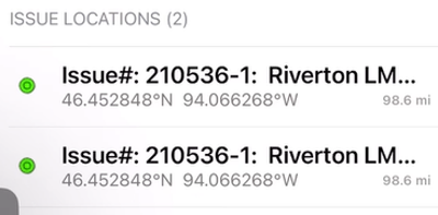

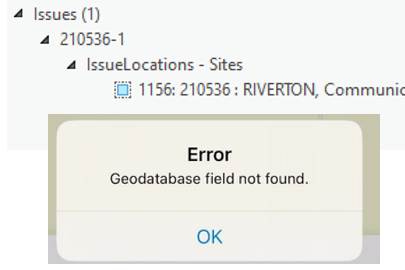

The row on the related table is now showing 2 times.  I verified in Pro that there is only one row.
Now the field crews are not able to submit photos
Survey123 is not being used.
I created a new point and related table row and it does not replicate.

I opened the application using Collector. it also shows to entries but did allow me to submit the photos.
