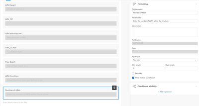

Hello @Anonymous User - I am having a similar issue to those in this thread where I am getting the error message "The form contains unsupported data". For this map, I created a feature called ARV_Inspections that I would like to be able to fill in using the form from the Field Maps mobile application. I went into the troubleshooting on the app and saw the note "ARV_Inspections: Info references fields that are missing in the table: ["struc_dia", "arv_count"]. These used to be fields in my layer, however, I deleted them and replaced them with fields of different names (struc_dims and arv_num). I also went through the form and I am not seeing a reference to the old fields.
Do you mind taking a look at my map and seeing if there is something I am missing? Thank you!
by Anonymous User
Not applicable
Hi @GregFields I see both of those fields referenced in your form as:
You can tell there is no field because the "Type" property of those elements/fields is empty.
If you removed those from elements and save the map, then it should work as expected after you re-load the map in the mobile app.

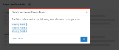

Based on the discussions in this thread, we have added additional warning/error messaging in the web app when fields that non-longer exist are used by existing form elements. This detection will be available next week (~ June 30th) with our latest update of ArcGIS Online:
