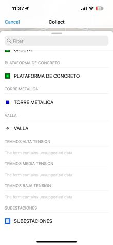

Hello,
we are creating some maps in ArcGIS Online to collect data using field maps. We are using IOS devises and Android devices, we hare using latest version of Field maps 23.2.2 Build 1016 and IOS 16.5.1. When we use the web map using Android devices, we are able to collect using all layers with no problem, but when we use IOS, we have several layers (5) that are not supported. all layers, including those that do not work has domains and contingent values. what could be happening? also even if the map is shared with organization i cannot see the map on field maps, so I need to read it from the QR code to be able to open it.

Update: we did a test and we notice that if we have contingent values required, we got the "The form contains unsupported data" but once we removed the required option, we were able to use layer.

Hello,
I did not explain myself correctly. Not the contingent value, the field or question that needs to have a certain answer to appear. that question (field) does not have to be required, once we checked that option, we are received the error message.
