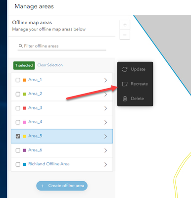

When you 'pushed' changes, did you re-create the Offline areas, or just Update them?
R_
JustinH
This is something I have not tried, I actually did not even know about this. We usually have the user create their own offline area.
