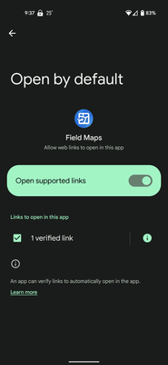

On Android can you go to Settings->Apps->Field Maps? There should be a setting called "Open by default". Tap that. Check if the "Open supported links" toggle is checked and that the link is verified.

Thanks Aaron, that did the trick!
