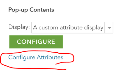

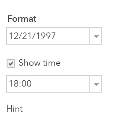

The only reliable way I have got it to work is in the map set it to use 24 hour time.
I still use Classic Map Viewer and set it like this
Not sure where in new map viewer but try that.
DougBrowning
MVP Esteemed Contributor
Kristy_Snyder
That worked, thank you!
